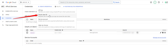

- Click on "Credentials" in the left-hand menu.
- Click on the "Create Credentials" button and choose "OAuth client ID".

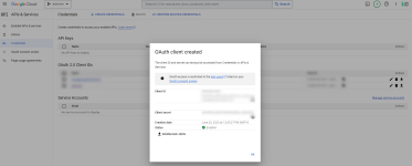

- Click on "Create" to generate your credentials.
Adjust your redirected url from Google Consol as below:
Then click create button and you will get Google Login Cliend ID and Client Secret as below:

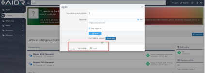

Then you will be able to use google for login as below:

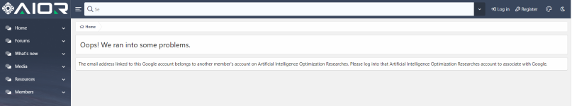

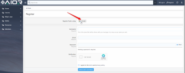

If you try to login with an ellready registered account first time you will get an error like below:

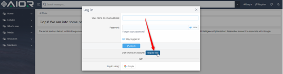

It means that you need to connect your accounts as below: Use register option will not work as below:
Continue with register with google option:

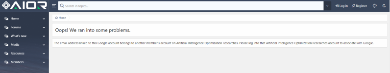

Same failure:
Solution for allready existing members:

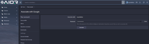

Method 1: Associate your existing account with Google
If you are the owner of the existing account with that email, then you can simply associate your Google account with your forum account.
Once this is done, you should be able to use the "Log in with Google" feature without receiving the error message.

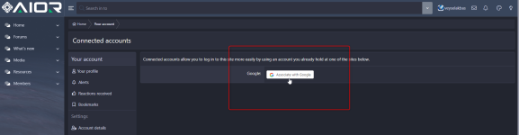

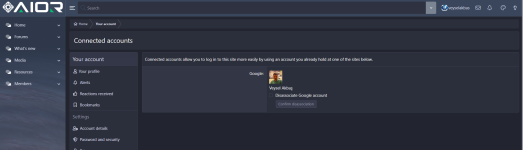

Use you password last time for login and continue with assosiate button.
You will see that your account is connected as below:
Next time you will be able to use Google login option with xenforo without any problem. You can log out and login again to test it.
Oops! We ran into some problems.
The email address linked to this Google account belongs to another member's account on Artificial Intelligence Optimization Researches. Please log into that Artificial Intelligence Optimization Researches account to associate with Google.
Same failure:

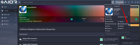

- Navigate to your account settings or preferences.
- Look for a section related to "Connected Accounts" or "Social Accounts".
- Here, you should see an option to associate your account with a Google account.
- Follow the prompts to log in with your Google account and connect it to your existing forum account.
