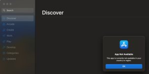

When you try top open that's what you get:
When you click search App Store you would find nothing:

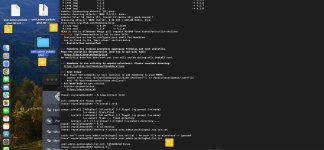

2. Install Zstandard (zstd)
Once Homebrew is installed, you can easily install Zstandard by entering the following command in the Terminal:
install zstd
3. Decompress the .tar.zst file
After installing Zstandard, you can decompress the `.tar.zst` file using the `unzstd` command. To do this, navigate to the directory containing your `.tar.zst` file using the `cd` command, and then execute the following:
Take your file to desktop
and at terminal type
cd desktop
Then type your filename with:
unzstd user.admin.psikologbul.tar.zst.zst
After that you will get your file with .tar. Then double click that file with sequence below:
